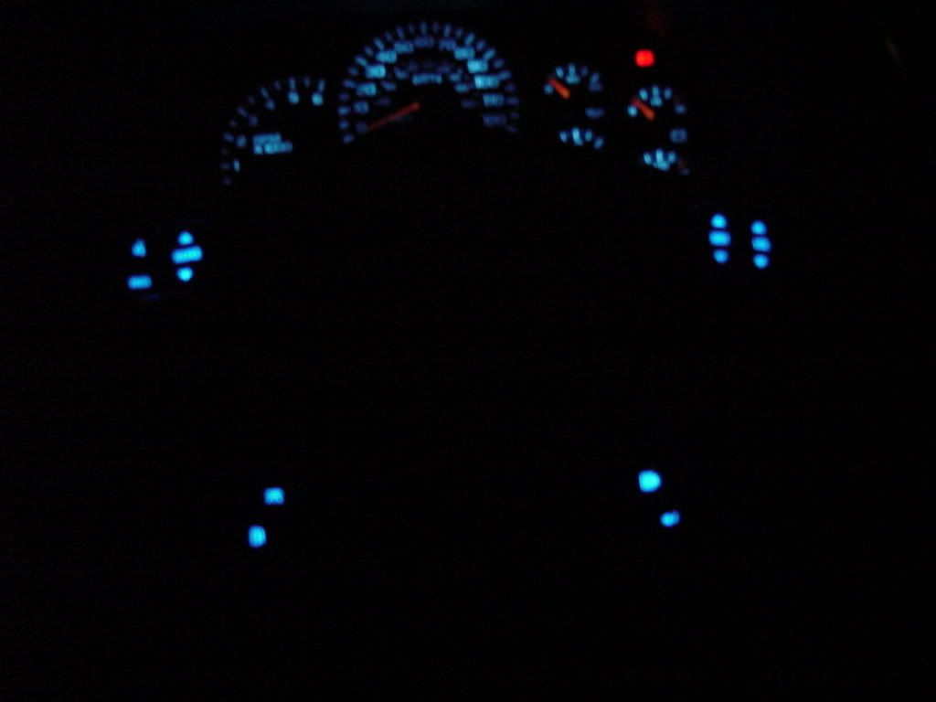

    They aren't that hard. Want them fixed like this?? The pic is kinda blurry, but I replaced every light in my truck with an LED, even the door switches.

    Do you have any instructions on doing the LED swap? Any resistors involved? I thought about doing this, but would need more info before I'd try it. At first glance, I'm not even sure how to dig into the steering wheel. I didn't see a way to get the the horn/AB off (unless you just pull it off??). Any insights would be greatly appreciated!

    I don't have any instructions on how to do it, but I can do it for you. To get the steering wheel off, there are two holes in the sides if the wheel that release the air bag, you push in with a small screwdriver and it will come straight out. I left the wires for the airbag connected when I did this. Then you just gently pry the buttons out and disconnect the wires. I re-routed the wires for easeier access when re-installing the buttons. You have to use a resistor for each LED.
