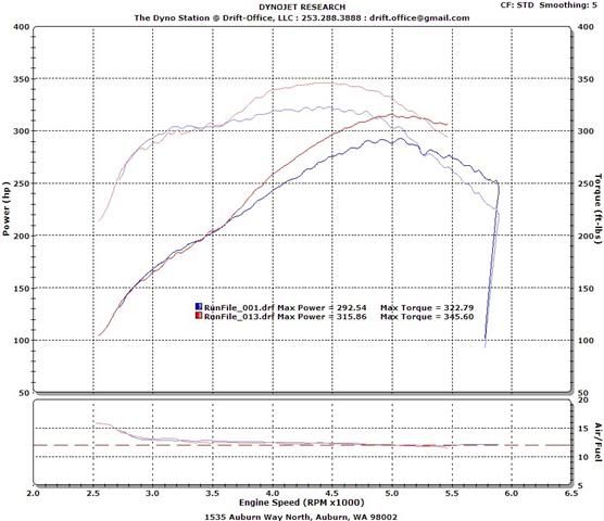

    Finally some numbers.
    seems a little low?
    lower hp/tq numbers were before tuning it on the dyno
    it was about 90 degrees in the shop so that could have played a part.
    for those who dont know my set up:
    383 ci 10.5:1 cr
    243 heads (stock)
    220/220 .551/.551 114LSA
    90mm intake and tb
    Ebay lt headers no cats 3in cat back
    E-fans
    running through 4wd, 4l60e, tb stall, 3.73 gears, and 33in tires
    what do y'all think?
    2003 GMC K1500 ECSB running an Iron 383 Stroker ......
    With your 4x4, small cam, 3.73s, and 33s, I'm not surprised at those results. You have some nice TQ. I wouldn't be upset with those results. All that matters is that you are happy with the truck and how it runs. I know you wanted something streetable and that's what you got.
    They're just numbers. Do ya smile when you get on the gas?

    i really love your torque curve. thats the curve that i'm aiming for. overall, not bad numbers.

    I am definitely happy with how it runs and jumps when I get on it. I guess I was just surprised how low the numbers were. My tuner also commented on the nice torque curve.

    I'd be a little upset with those numbers i figured a 383 would do better than that at least 400 range.
    Yeah man. I was expecting numbers in the 400 range.

    Whats your comp ratio? are you planning to boost?

    10.5:1 cr and yes I plan on a trick front mount this winter

    Going back to the dyno today with the new set-up
    226/230 112LSA EPS cam
    Lunati Dual Springs
    1 & 7/8 ARH Headers
    also running my lighter wheels on the back. little cooler today than last year. got the correct length pushrods (didn't before... doh!).
    running through my new FLT Lvl5 and Yank 3k verter
    fingers crossed!
    I'll post #s later today!
