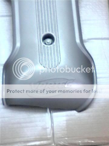

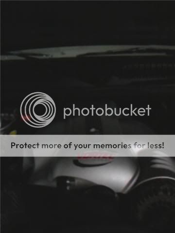

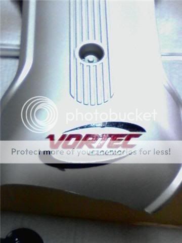

    Painted them today, let me know what you guys think.
    [IMG][/IMG]

    I like that a lot. Might do that Myself. Did you rattle can it, or use a gun?
    Bakersville, NC
    608
    Rattle can. Started with 3 coats of adhesive promoter, 4 coats of high temp engine aluminum engine enamel and finished with 4 coats of the dupli color clear coat type paint foe wheels. There's still a few details to be worked out on them and have to touch up a spot or two on the pass side cover from re-installing them. But all in all turned out good, took me about 5 hrs. The long part was the finishing touches, hand painting the vortec emblem with a brush. I'll post some better pic when i get the soft ware for my camera reinstalled on the comput.

    Can you make the picture bigger or clickable? I'm interested.
    Bakersville, NC
    608
    Sorry pic were taken with my phone, and I am unable to upload pic from my wifes camera the software for it got deleted off the computer some how.
