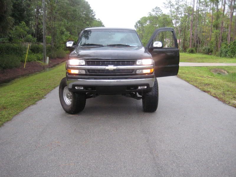

    if you not going to offroad it hard then there is no use of a solid axle. some of the fastest diesels are still running the stock ifs set up with just beefy tie rods. so you running it hard on the street does not touch what ifs is capable of. now if you were going to off road it hard with some 38's then ii would say go for it. but like i said its not worth spending 4 to 5 grand to switch to a solid axle and drive it hard on the street. save the money and buy your self some nice tie rods. Because under-load they will snap like a twig.

    is that a broken tie rod or is it just being bashful? LOL

    Dang 6.0 how did that happen? Your truck isn't dirty like you were playing in the mud or nothing.
